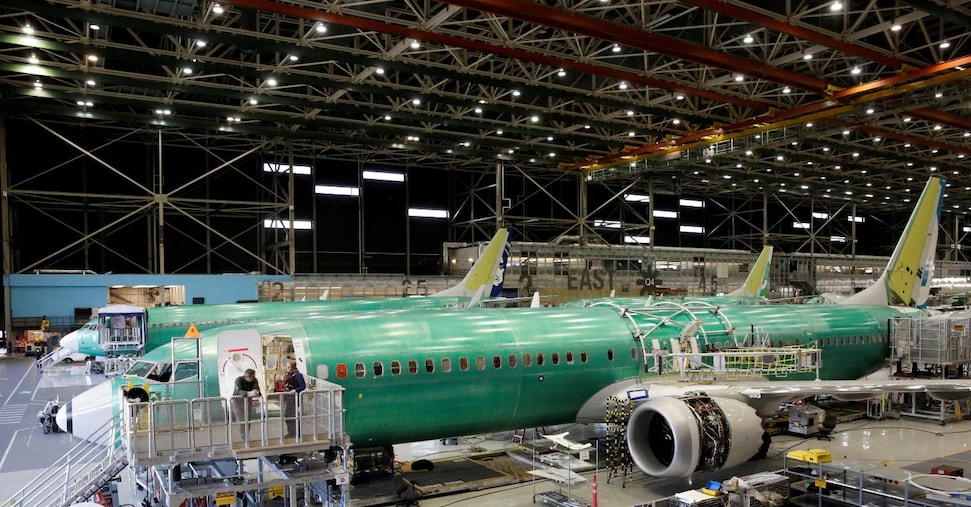

  • Boeing's assembly facilities in Renton, Washington, will pause for 24 hours on January 25 for a 'Quality Stand Down' session focused on improving quality processes.
  • Employees who work on the assembly of the Boeing 737 aircraft will evaluate their work and make recommendations for improvement during the session.
  • The sessions are part of Boeing's efforts to address manufacturing lapses following the grounding of the 737 MAX 9 and to strengthen its quality management system.
