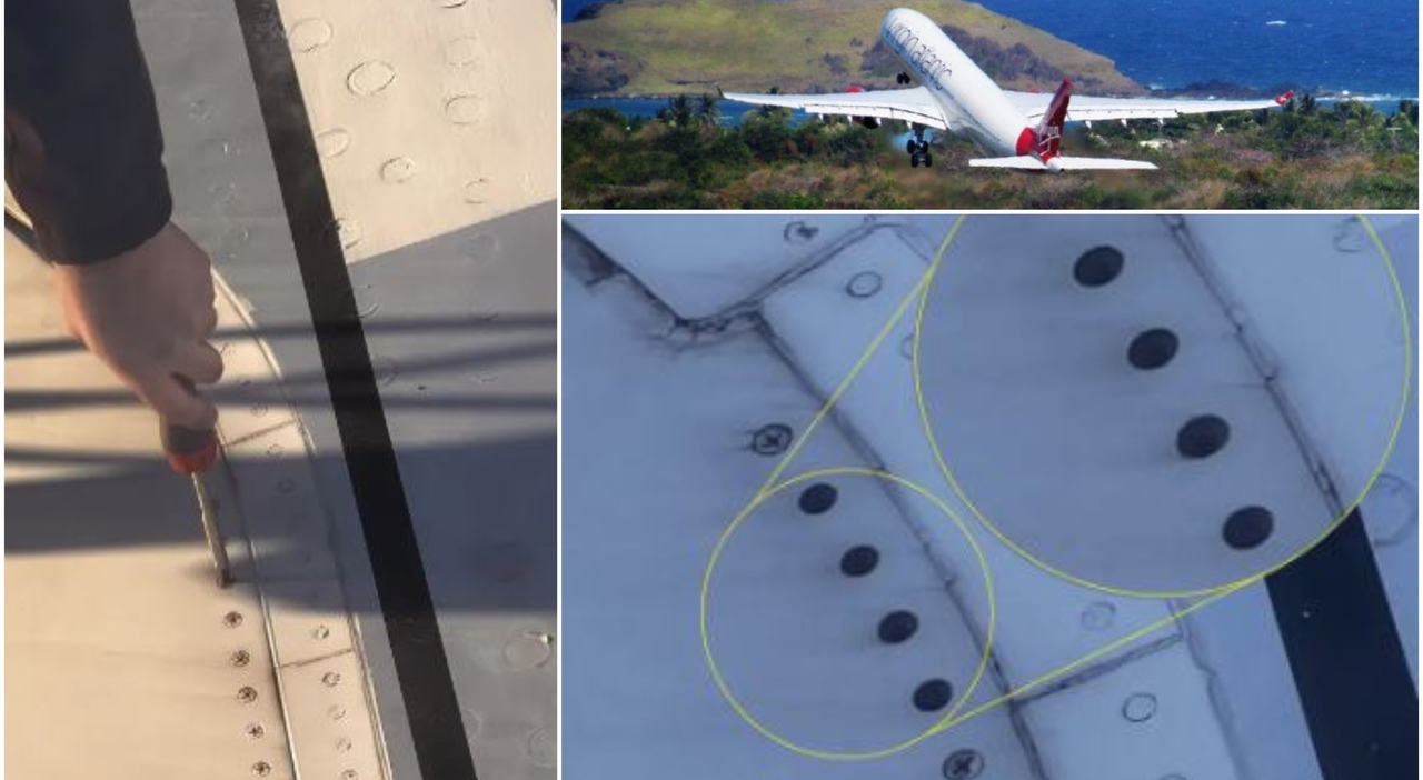

In questo caso non è una AD come per il MAX9, ma "solo" un SAFO per gli 737-900ER
Alcuni passaggi interessanti:
Discussion: The Boeing 737-900ER mid-exit door plugs have an identical door plug design to the 737-9 MAX. As part of their Safety Management Systems, some operators have conducted additional inspections on the 737-900ER mid-exit door plugs and have noted findings with bolts during the maintenance inspections.
Quindi hanno trovato discrepanze anche su alcuni 737-900 in servizio da anni, dove la manutenzione ha già rimosso / installato questi bulloni...
Recommended Action: Operators are encouraged to conduct a visual inspection to ensure the door plug is restrained from any movements through the two (2) upper guide track bolts and two (2) lower arrestor bolts. Please refer to the Aircraft Maintenance Manual and 737-900ER Fuselage Plug Assembly Maintenance Planning Document (MPD) for more information, regardless of if this inspection has been conducted under the existing maintenance program prior to the EAD. As Operators conduct the visual inspections, they are also encouraged to report findings to their certificate management office.
