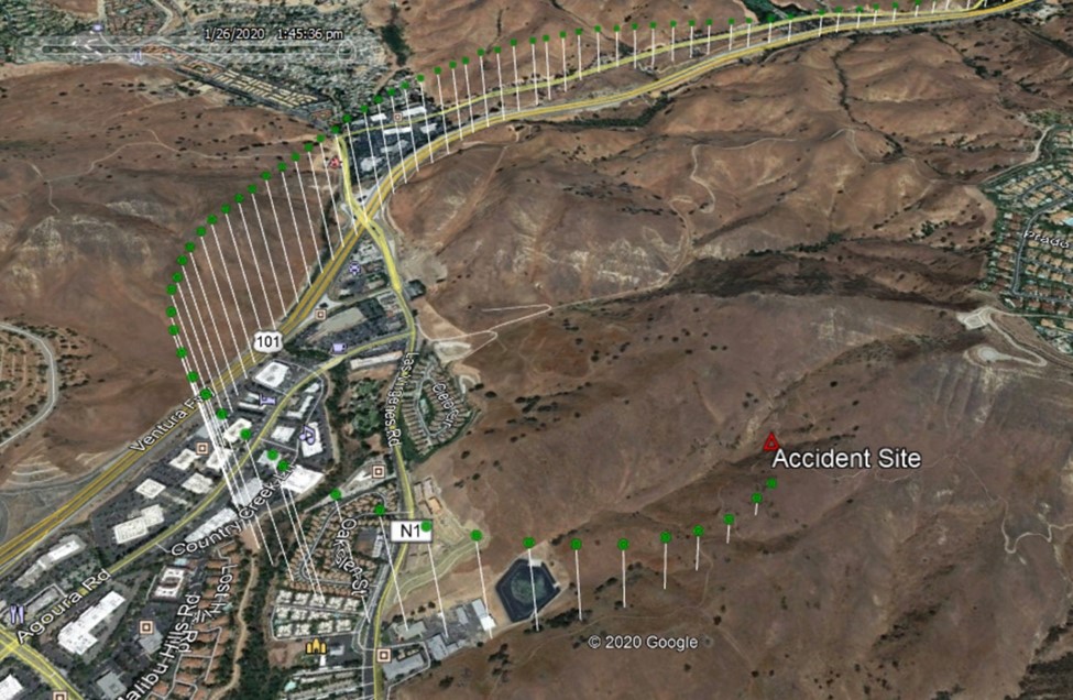

Photo illustration from radar tracking the last minute of the flightpath of the Sikorsky S-76B helicopter.
(This photo illustration is from radar tracking the last minute of the flightpath of the Sikorsky S-76B helicopter. Google Earth image, NTSB graphic overlay by Bill English).
